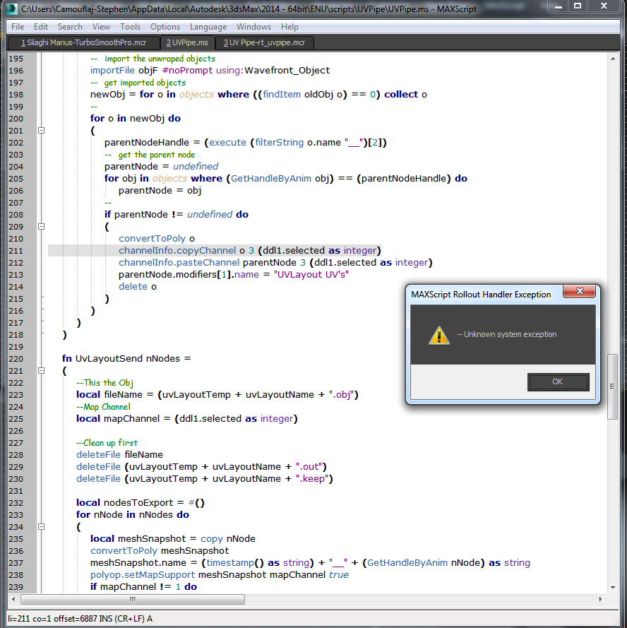

PostPosted: Thu Jun 19, 2014 8:27 am    Post subject: UVPipe Script Crash when creating UV Set 2 and 3 Reply with quote
They Guys, Im using 3d Max 2014 and when i use UV Pipe it seems to work with Uv set 1 but Uv Set 2 and 3 Crash when you send the asset back to max. I attached the Script crash. Any Ideas how to fix this?

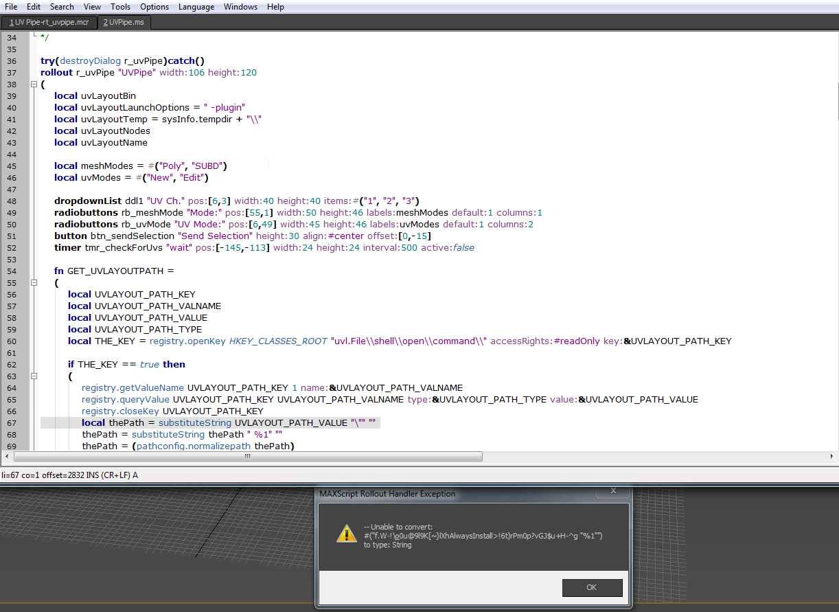

PostPosted: Fri Sep 26, 2014 9:16 am    Post subject: Getting an error running plugin with Max 2015 Reply with quote
Plugin doesnt seem to want to work with 3dsmax 2015, any help would be appreciated.
-Z
 Filesize:  92.82 KB
 Viewed:  68515 Time(s)
