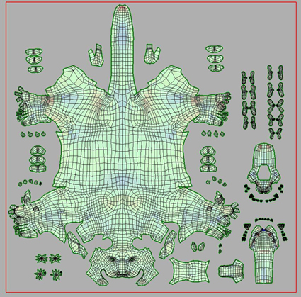

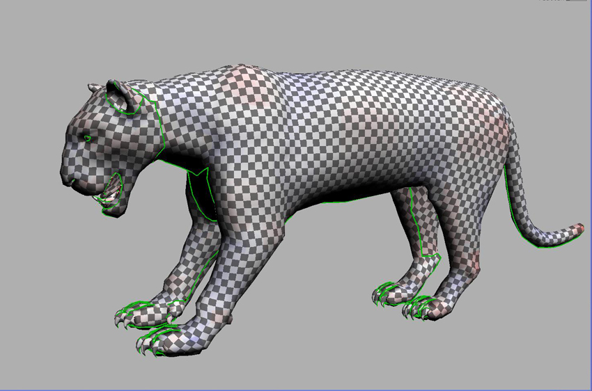

I am creating this beasty for the "Cgtalk HMC10: Animals in Motion" and thought you might be interested in taking a look at it. I sure am interested in your opinions and perhaps further advice and comments on the unwrap. Wink
Lets hear it from you guys! Very Happy

Looking good! By the way, if you want those UVs to be perfectly symmetrical, you can use the Symmetry Find tool even on an existing layout. Have a look at the videos in the "Advanced Tools" section of uvlayout.com/videos. The second one I think shows you how to apply it to already flattened meshes.

However, I ran into weird issues were the symmetry would not work on isolated polys (dark yellowish coloring) spread out randomly over or close to parts of the outer edges, although the mesh is completely symmetrical. So I had to disconnect those parts and flatten them speparately. It all worked out nicely though, so no big deal. Any ideas or suggestions what could be the issue?

"... (dark yellowish coloring) spread out randomly over or close to parts of the outer edges, although the mesh is completely symmetrical. "
Yes, the yellow polys usually indicate a point of difference between the two halves. It could be a triangulation difference, similar to the one seen in this posting ...

Cool. Good luck in the competition. That map looks ideal for some seamless texturing. Maybe put a couple of extra darts in the tip of the tail, unless it'll be hidden by a few separate tufts of hair parented on the end.

What do you mean by "darts"? One-edge cuts?

I think it's a tailoring term .. it means cutting one or more slits into a mesh from the edge. Allows compressed or stretched polys to resize. The red on the tail tip indicates compressed polys, so cutting the single dart that's already there even deeper might be a problem, because the polys want to expand (they'll overlap). Just work out where the tension is, and experiment with a few small cuts to lessen the red.
Normally a small amount of red isn't a problem, but you really want sharp hairs on the tail tip to make your animation zing.

I already followed your advice and reduced the red on the tail with a dart there. One and some additonal flattening were enough to do the job.
