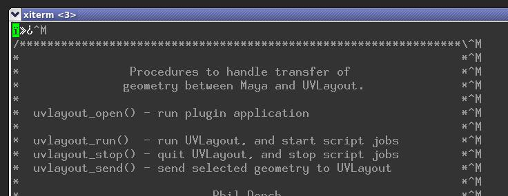

PostPosted: Thu Oct 13, 2011 9:46 pm    Post subject: Reply with quote
Great!
For anyone looking at this in the future, the problem *was* bad characters at the start of the edited MEL file. The image below shows them in a text editor that doesn't hide the unprintable characters.
Bad characters in MEL file
