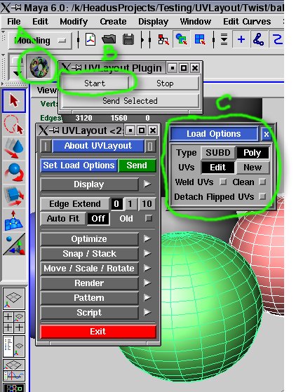

Run Maya, open up the UVLayout shelf, then click on the torus icon to open up the plugin interface window (see A below). Next, click on the Start button to run UVlayout itself (see B below). Finally, select the Load Options, specifically if you're going to be sending across polymeshes or subdiv surfaces (see C below).

Use the usual Maya actions to select one or more poly objects, or a single subdiv object, then click on the interface plugin's "Send Selected" button. The selected object should then load up in UVLayout after a second or two.
How to get objects back from UVLayout:
When you've finished flattening those objects in UVLayout, click on UVLayout's "Send" button. Then back in Maya just tap the 'x' hotkey; Maya should then load the flattened objects, replacing the ones you originally sent to UVLayout.
