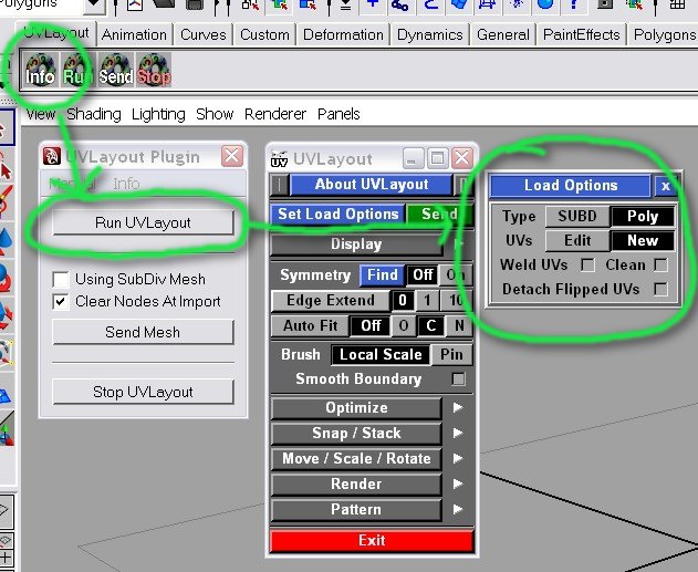

Here's a new version of the interface plugin for Maya, kindly provided by Wolfsong; it allows you to run UVLayout from within Maya, and selected objects can be sent back and forth with the click of one button or hotkey.
How to install it:
First, check that Maya's OBJ export plugin is loaded; you can do this via the "Plugin Manager" (check your Maya documentation for details).
Next, grab the ZIP file below, extract its contents, then put the uvlayout_open.mel script into your maya scripts directory, the XPM files into prefs/icons, and the shelf MEL into prefs/shelves. Typically these directories are here ...
    Windows: C:/Documents and Settings/<your_username>/My Documents/maya/<maya_version>
    Windows 7: C:/Users/<your_username>/Documents/maya/<maya_version>
    Linux: $HOME/maya/<maya_version>
    OS X: /Users/<your_username>/Library/Preferences/Autodesk/maya/<maya_version>
If installing under Windows, you may also need to edit the uvlayout_open.mel script so that the uvlayout_home function returns the install location of UVLayout. By default its set to "C:/Program Files/headus UVLayout v2 Demo", so if you purchased a Student, Hobbyist or Professional license, you will definitely need to change that. You can do that with Maya's script editor. If you use Notepad to edit the file, make sure you save using ANSI encoding.
Its the same for OS X. The default location is "/Applications/headus-UVLayout-Demo.app", so you will need to change that for the other licenses in uvlayout_open.mel.
You may also want to define a hotkey within Maya that calls the uvlayout_send function; I use Ctrl-U. This saves you from having to click on the Send button or icon. In fact you can kill the interface window, once everything is going, if you define a hotkey to send objects to UVLayout.
How to start it up:
Run Maya, open up the UVLayout shelf, then click on the "Info" icon to open up the plugin interface window. Next, click on the Run button or icon to run UVlayout itself. Finally, select the Load Options, specifically if you're going to be sending across polymeshes or subdiv surfaces (see image below).
How to send objects to UVLayout:
Use the usual Maya actions to select one or more poly objects, or a single subdiv object, then click on the "Send" button or icon. The selected object should then load up in UVLayout after a second or two.
How to get objects back from UVLayout:
When you've finished flattening those objects in UVLayout, click on UVLayout's "Send" button. Then back in Maya just tap the 'x' hotkey; Maya should then load the flattened objects, replacing the ones you originally sent to UVLayout.
How to exit nicely:
When you're done flattening objects, click on the "Stop" button or icon. This will not only kill UVLayout, but it also stops the background script jobs.
