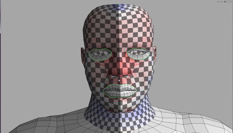

bonga
Posts: 4
Joined: 22 Jul 2012
Posted: Tue Jul 24, 2012 2:27 pm Post subject: |
| headus wrote: | Maybe if you could move it back a bit so it goes behind the ear, then you could hide it under the hair if you needed to.
Depending on the software you are using though, where the seams are may not be that important. If you're using a 3D paint box then it should handle painting across seams properly with appropriate bleeds in the map. And with good UVs (from UVLayout of course the pixel density on either side of the seams will match, so it wont appear blurrier on one side for example, and you wont see any seams in the final renders.
Hero characters in the movies like King Kong have UV seams all over the place because they need to use multiple UV tiles to get very high texture resolutions, but you dont see any seams in those renders.
Phil |
Thanks Phil for the help.
I've been working hard to understand this UV thing.
I have a few more questions and i'ma outta ya neck and hairs. I PROMISE.
The red is bad, right? The Green is good? The blue is bad?
Does the squares have to be a perfect square?
Thanks.
| Back to top |
headus Site Admin
Posted: Tue Jul 24, 2012 6:29 pm Post subject: |
Red is probably worse than blue because it means that any texture applied will be stretched at that point making it blurrier, but if you look at the size if your squares, even in the red tinted areas, your squares aren't that much bigger than they are elsewhere.
The aim isn't to completely get rid of blue or red areas, because to do that you would have to put seams all over the place. Think of the red and blue as helpful feedback ... you dont have to bend over backwards to make it all go away.
Creating UVs is always a balancing act between seams and distortion, and with trial and error and experience you'll learn what balance is appropriate for a particular model or application. What you have there in those latest pics looks pretty good to me.
Phil |
