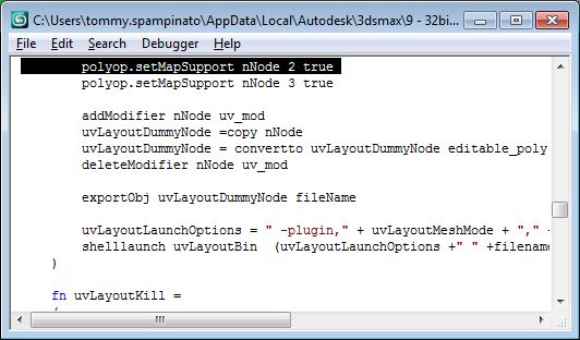

I still have problems using the UV pipe tool where it throws up an error if i do not have UV coordinates on uv channel 2 and 3. My work around is that I manually apply uv coordinates in Max for 2 & 3
I am using a batch exe for UV layout
I am using Max 9 64 bit. Soon we are switching to Max 11 or 12.
I have never been able to get this to work right.
Thanks!
