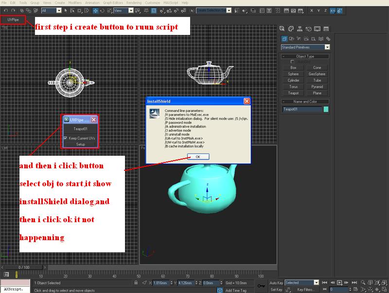

Thk guy,for answer but i still a problem,pls to see a pic, and ans me thanks

miss pic,sorry pls see again

by the look of that dialog box you've pointed the plugin to the uvlayout installer file that you downloaded from the site. What you need to do is install uvlayout from the installer file. then in the plugin go to setup and set the uvlayout path to the uvlayout.exe which is usually found in "C:\Program Files\headus UVLayout "
Now it will run

i got it,so thank for any help,first time i set "C:\Program Files\headus UVLayout "
but it not still run and i try move uv_pipe.ms to C:\Program Files\Autodesk\3ds Max 2009\Scripts.it worked Very Happy
but i still have any Question about uv layout program,as corlor code and many. so i will ask u again.now i must to say thank u very much Laughing

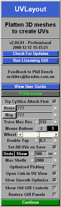

I am having trouble with your script. that or Headus. I have no idea what could be wrong. I was working fine up until Friday when all of a sudden importing back from UVLayout gives me an error in 3ds max "No UVs were received from UV Layout" This has happened before but I can't remember or figure out how to fix it.
I am using 3ds max 9.
For the record i am able to export an OBJ out of max, load in UV Layout, save and import files back in. but that is not good form me becasue I lose vertex data like alpha and color. Your script was a time saver I hope you can help me out.
Thanks!

I'm not that familiar with the max plugin, but you may need to have "Set All UVs on Save" ticked in UVLayout's preferences.

I did not do anything different on friday. Maybe when i had a hard crash it might have corrupted something? The script just stopped working properly. I tried re installing/upadting uvlayout and the UVpipe script and I am still having trouble. I can't even import UVs using a generic primitive like a cube or sphere.
When I import I get the error and what looks like a new un textured mesh over the old mesh. when I klick OK in the error the new mesh disapears leaving my old mesh and no new uv edits.
Tommy.

Those prefs look fine.
I found this in the first post for the max plugin ...
"*I've introduced my own OBJ loading code finally. This removes the need to worry about setting MAX's import presets to fit the script. This has the nice side effect of allowing me to load the uv data straight from the file into the object with no need to import a mesh. "
So that whats r_knightly is working on for the next version, which implies that the current version would be using max's own OBJ import and settings. Check there in case something got switched off or on?

After you post I looked and noticed my import settings got messed up by someone trying something on my PC when I was away. Import textures was un checked...
Total Noob Mistake! At least this time I did not freak out on you. Smile
