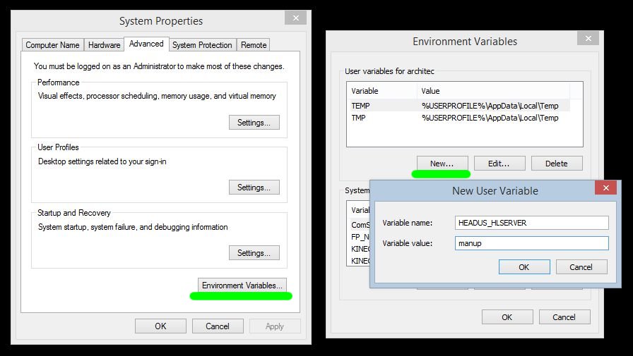

The solution is to set that variable within the OS. See below for
doing that manually on one system, but I'm sure an expert Windows
sysadmin will know how to do that easily as a global network setting.
If you have Maya running when you make any environment variable changes,
you'll need to quit and restart for those changes to be picked up.
