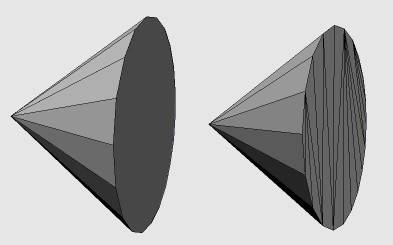

PostPosted: Fri Jul 13, 2007 2:38 am    Post subject: Reply with quote
In the current version even a simple cone will be modified (triangulated) when its loaded, and this breaks things like morph targets and the new Maya plugin (it relies on identical topology between objects to copy UVs).
I don't expect anyone to get close to the 256 sides limit, but you never know!

PostPosted: Fri Jul 13, 2007 1:16 pm    Post subject: Reply with quote
Ah I see now .....after 7 sides UV Layout would triangulate the poly. I always like to know my triangle flow. Its good to know its there if needed.
