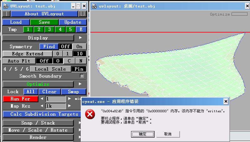

I have tested it and find something wrong:
every time ,when completed flatten and export ,it shows "cyeat.exe err"--to see attachment err.jpg,and it has a dumpxxx.txt .
and can i tick the Outline option as default,so I do not need tick it everytime.
and how can I know when flattening is completed,then I can do next.
thank you .

PostPosted: Fri Aug 03, 2007 6:35 pm    Post subject: Re: thank you very much! Reply with quote
"when completed flatten and export ,it shows "cyeat.exe err""
Look like you're hitting this problem ...
http://www.headus.com/phpbb/viewtopic.php?t=202
"can i tick the Outline option as default,so I do not need tick it everytime."
No, sorry, it currently doesn't remember the setting from session to session. But the way the plugin interface works is that the GUI can stay running, and you just keep feeding it new files to flatten, and the outline setting will then apply to all saved files.
And you know when the flattening has finished when the output file has been created. Get your application to watch for that file.
