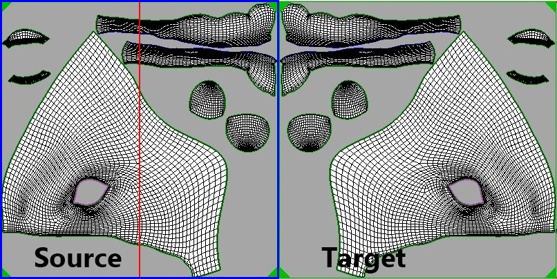

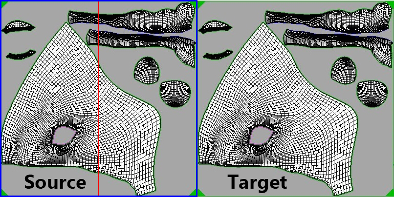

"I'd like to copy my Uvs in an other shell but in the exact same position of the copied one."
Copy in U axis:
That's what I'd like to have, the shell are in the same position relativly to their tiles.
And having the option to choose to having it flipped (from the center of their respective tile) or not.

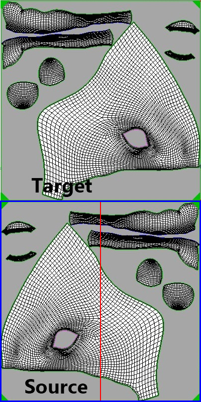

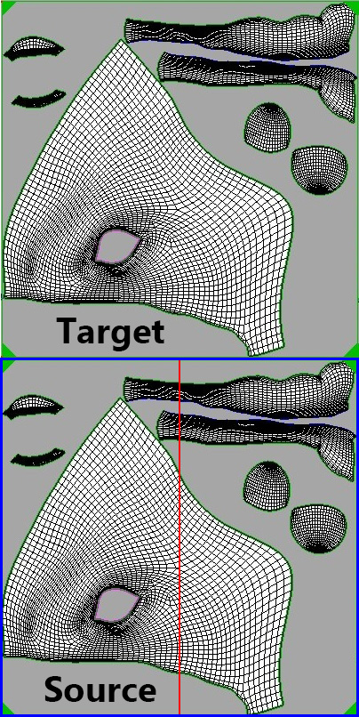

Copy in V axis:
Same for the V axis.
Basically it is just a copy stack plus a move in U or V with a value, here of 1.

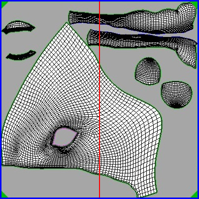

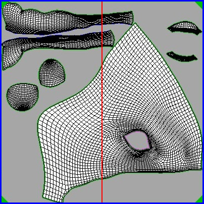

About the flipping into the tile here is what I meant, the red line represent the center axis of the tile, the 0.5 coordinate in U relative to the tile.
At the moment if you use the arrow key to flip the shell in a tile it does it arround the shell axis, I'd like to have the choice to flip it around the central axis. Like in the pictures above.
