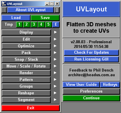

Hi Phil,
I have just installed UVLayout onto my PC box at work, I am using my personal dongle which is working fine.
Whats missing is the option to install the plugin for maya.
The option doesnt come up when installing the latest version and from the about UVLayout window, there is no option to install the plugin.
That doesn't seem right, any idea how to get around this?
Cheers,
Michael
 Filesize:  152.9 KB
 Viewed:  29016 Time(s)
View user's profile Send private message Send e-mail MSN Messenger
PostPosted: Fri Sep 05, 2014 2:45 am    Post subject: Reply with quote
It looks for one of the following folders in your home folder, and if they're not there, it hides the install button.
My Documents\maya
Documents\maya
maya
It'll also check for the MAYA_APP_DIR environment variable, which can be defined to point to an alternate maya folder.
And finally, you can override all of the above with the HEADUS_MAYA_LOCATION env variable (i.e. set it to the path of your "maya" folder if its not in your home folder.
