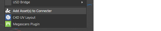

PostPosted: Fri Jul 22, 2022 12:55 am    Post subject: Does'nt work on C4d R24 Reply with quote
Hello,
I acquired C4d R24 and the plugins still doesn't work Confused
it appears in the plugins menu but when you click, nothing happens
