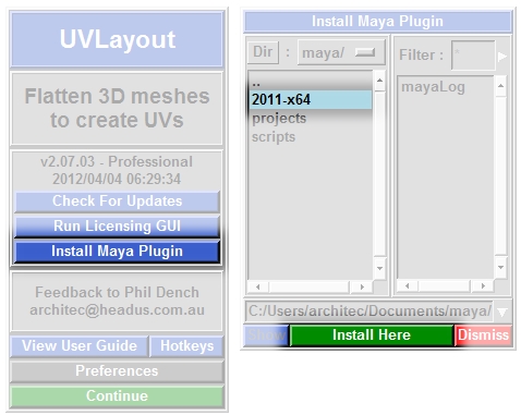

Next, run UVLayout and click on the "About UVLayout" button at the top of the GUI. If a Maya installation was found on your system, an "Install Maya Plugin" button will be there. If the button is missing, read this post.
So click the Install button and a file selection window will appear, where you need to select which version of Maya you want the plugin files installed into. Next, click the "Install Here" button and the plugin files are copied into their appropriate folders. You can then exit from UVLayout, start Maya, and you should see the UVLayout shelf.

Installing the plugin.
 Filesize:  76.6 KB
