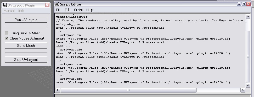

Edit uvlayout_open.mel and look for the debug variable ... set it to "1", reload the script, then you'll hopefully get something like the attached image in the Script Editor window when you try and "Run UVLayout". It confirms the setting of the "home" variable, then checks that uvlayout.exe exists in that folder, then shows the "start" command used to run UVLayout.

Hey Phil, thanks for the help! I was looking for a debugging line to see what was going on, but I`m no scripter, just simple artist Smile
This is whats going on when I click on RUN.
Code:
uvlayout_run;
uvlayout -plugin uvl4128.obj > /dev/null 2>&1 &
Sort of says something is bad to me, as its not like your image.
